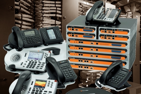

Tips for securing your ShoreTel system against call-back fraud
* Note: Disabling Trunk to Trunk connections is one way to combat this, if you are in the office and you listen to a voicemail the 5-2 option will work as you are not on a trunk call. Out of the office as would a hacker would reside, the option will fail the call if you disable in COS.
Note, this will also prevent an inbound call from being transferred off site to another phone number. However if this is not needed / or you want to tighten up security not to mention save on a trunk to trunk transfer, as you pay for the entire length of the call / then disabling should be good.
NOTE: Usual disclaimer applies here. These are just my thoughts. Use the information at your own risk. Don’t trust just one guy on the Internet to secure your enterprise phone system. Ultimately no matter how much of a ‘belt and braces’ approach you take, it’s never going to be completely safe from attack. At the very least the threat from within is always going to remain. This post is more to ‘spread the word’ than to give any definitive advise.
Now that’s out of the way, we can continue. There has been a lot of bad press recently about call-back fraud and it’s costing UK businesses alone over £1 billion a year. I should say at this point that this is not a specific vulnerability within ShoreTel but rather an inherent issue with PBXs where a feature intended for convenience can be used for far more nefarious purposes.
There are a few key tips which can help reduce the attack surface and hence reduce the risk of a successful compromise by scammers. While this post focusses on how to achieve this on the ShoreTel system, the principles will be the same on many telephone systems.
1) Use a restrictive Class of Service by default
If you work for a company who never (or very rarely) has a reason to call Premium Rate or International Numbers – you are in luck. Set the global CoS to Long Distance only to avoid this being abused.
For a lot of companies however, this action would not go down well. It can take some research and time to get a picture of what is “normal” for foreign calls. Use the CDR tools. Involve management. Avoid blocking everything and then dealing with the aftermath.
2) Restrict call feature permissions
In a lot of cases, staff will tend to use the phone system on a fairly basic level…ie..to make calls. Find out how users use the system, and set the permissions accordingly. For instance, do most users require the trunk to trunk transfer feature? In my case, no, so for most user groups, this is not allowed.
The above to points take into account the well established Principle of Least Privelige
3) Ensure passwords are set to at least 6 digits – including workgroups
Not much to discuss here. Unfortunately, the system will not stop people using 000000, 123456, etc – ongoing monitoring of this is necessary. Don’t forget about workgroups. Those with a support contract can use the IDLint tool. Ask your ShoreTel partner if you are not sure how to get this.
4) Ensure new users passwords are not set to something easy
Simple tip really! Don’t use 0000 for new user PINs.
5) Don’t enable Voicemail by default
If users don’t need voicemail, simply disable it. Note, you can’t disable voicemail for a user with “Any IP Phone” set. It’s also no good for users who roam, as voicemail is needed to log off/on.
6) Set up Event Filters
Look for Event ID 1113 – This shows repeated failed login attempts to an extension.
7) Don’t forget meeting room phones, kiosks, etc!
Keep these locked down – Extension Only (no voicemail) and secure passwords.
And finally….Educate users & management
This is very much a non-technical yet important point but it’s one that’s often overlooked. Don’t just make this a typical inexplicable change that IT departments make. Prepare some information for your users, explain why it’s being done. Offer assistance. Doing all the above in one swift, brutal round of change will only cause a headache for you as your users won’t be happy. I personally take good measures to keep any negative perception of the phone system itself to a minimum. Of course, pigs will fly before all your users read the info – but this is not a barrier to not do it. Make it available.
